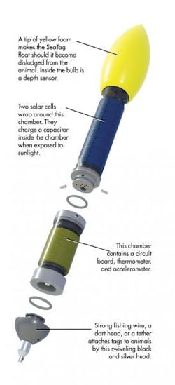

After curing, portions of the tags are wrapped in thin solar cells. The cells outperform batteries (which tend to be bulky) and traditional photovoltaics (which make electricity only from abundant solar radiation — in short supply underwater.) The thin-film cells collect sunlight for power and use it to charge a capacitor, which powers the tag’s other subcomponents.
When a shark pops to the surface with his tag, solar power lets the tag transmit data to the ARGOS satellite. The data details the shark’s movements, hunts, procreation, temperature and depth preference, daily acceleration activities, and even death. You can track tagged sharks in real time at rjd.miami.edu/education/virtual-learning/tracking-sharks.
“Fifteen minutes of sunlight fully charges the unit, and then the tag can operate up to two weeks in total darkness,” says Marco Flagg, chief engineer at Desert Star Systems.
Some traditional tags use solar cells to make power and report location (in terms of longitude and latitude). In contrast, SeaTags mostly rely on magnetometers for positioning.
A three-axis magnetometer detects the intensity and direction of Earth’s magnetic field transmitted through basalt on the ocean floor. Then the sensor converts the signals into position data and sends them to ARGOS. The inspiration for using magnetics comes from sea turtles and hammerhead sharks. It’s hypothesized that these animals rely on magnetics to migrate and find food.
