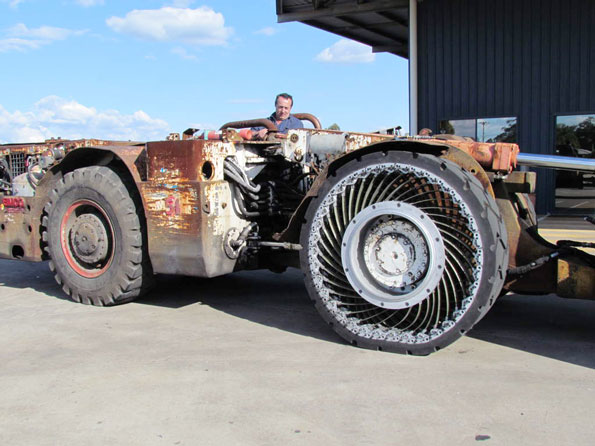

A mining vehicle sports one of Big Tyre’s leaf-spring tires.
Inflated and solid tires could go the way of the buggy whip, at least for off-road vehicles. Engineers at Big Tyre, an Australian firm that designs and manufactures heavy-duty tires for mining vehicles, has developed a new tire design that combines composites, metal, and rubber. It consists of composite leaf springs attached to a steel hub on one end and to steel or fiber segments that hold the rubber tread on the other. The leaf springs are four times as flexible as steel and symmetrically support the hub.
Of course, there’s no risk of puncture. The design also reduces heat entrapment and is expected to handle greater loads, speeds, hauling distances, and last longer than pneumatic tires. And the leaf springs still provide a smooth ride. It will also have the durability of a solid tire.
