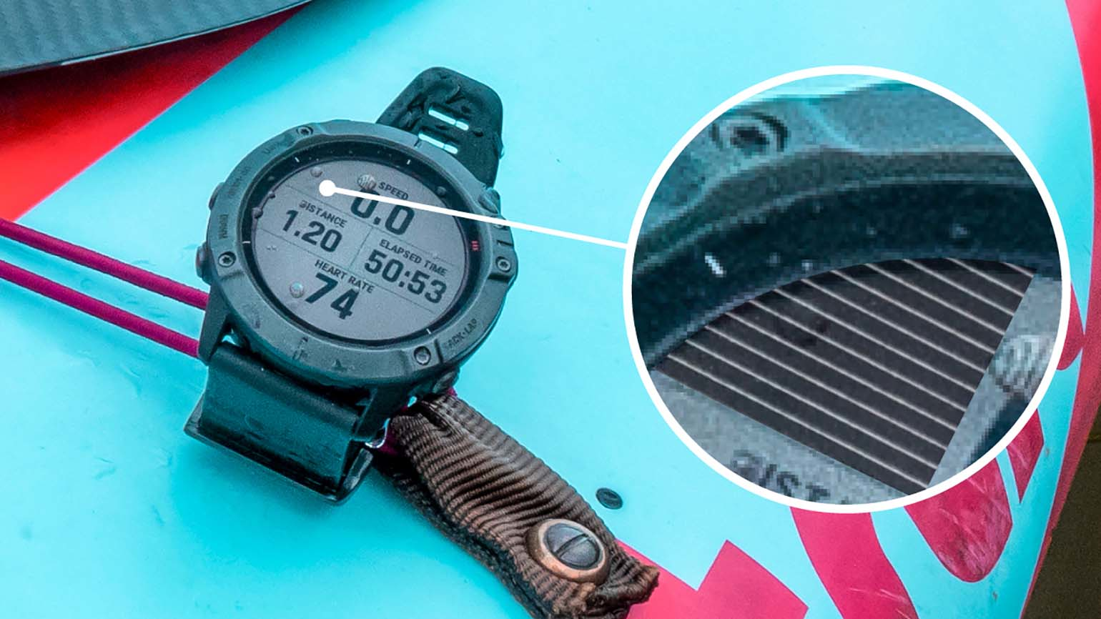

Small-scale energy harvesting is often an attractive option for supplemental powering of devices having ultra-low power or low-rate/low duty-cycle needs, such as wearables, wireless IoT sensor nodes and asset trackers. That’s because the absence of moving parts and the ability to fully enclose and seal the harvesting subsystem enhances their reliability and longevity. But implementing solar-based harvesting in tightly cramped settings is often a major challenge in practice.
Addressing that challenge is the MAX20361 single-/multi-cell solar harvester with maximum power point tracking (MPPT) from Maxim Integrated Products. It enables supplemental solar charging, providing an additional source of stored energy that, in turn, can extend the runtime of those devices (Fig. 1).
