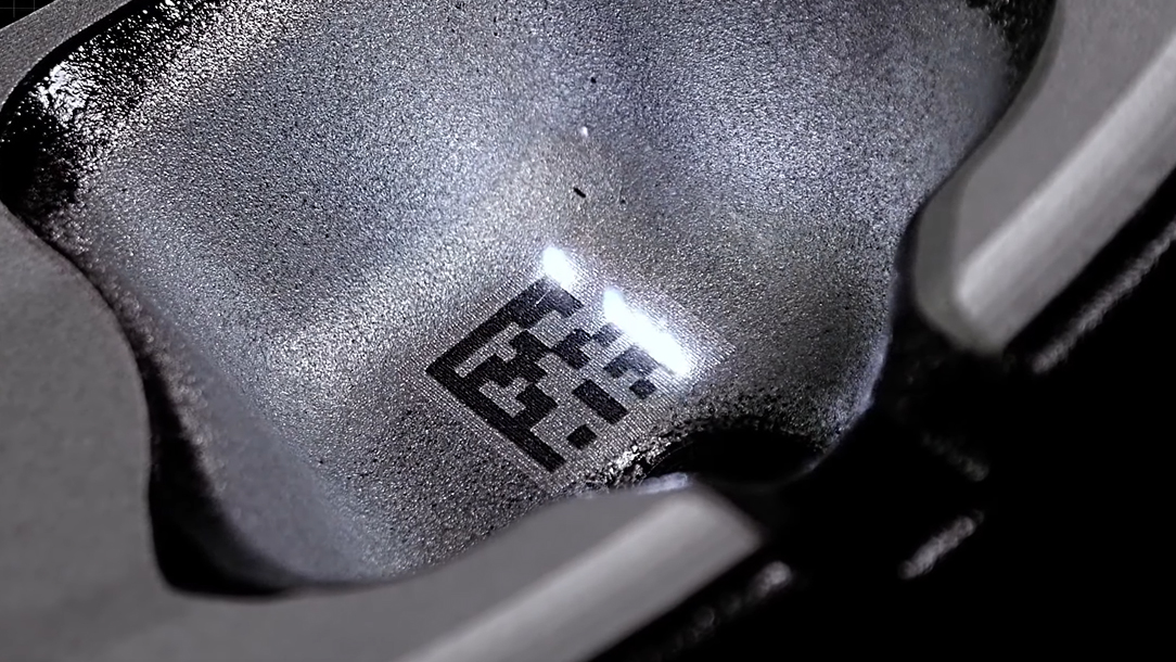

In particular, laser etching is the best way to create high-contrast markings on aluminum. It does this by modifying the surface of products at a microscopic level. During the etching process, the laser beam applies a tremendous amount of heat to the surface of the material, melting and expanding the material’s surface, and creating a texture on the microsurface that results in a color change and contrast mark.
As a result of the lasting changes to the surface texture, the marks are permanent, durable and resistant to abrasion and scratches. The barcode/text looks blackened while the background appears whitened (which enhances readability), owing to the way light is diffused from the marks.

Automotive parts such as suspension components, wheels, seat structures and engine components are exposed to sandblasting, e-coating, powder coating and other surface treatments. These treatments can affect the legibility of 2D codes.
To prevent this, manufacturers can use fiber lasers to engrave deeper codes that stay readable post-treatment. Laser parameters are adjusted to create a code that goes deeper into the material and has a rougher surface texture.
