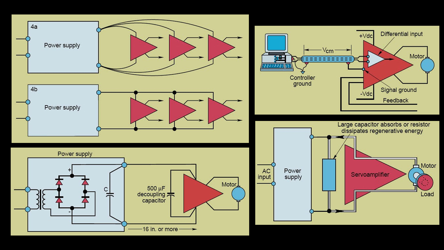

Controller-to-Servoamp
There are often several feet between the controller generating the motion commands and the servoamp. Although it might appear insignificant on a typical schematic like the one above, this separation often produces a ground voltage at the motion controller different from that at the amplifier. Without proper protection, this voltage difference, dubbed “common mode voltage” (Vcm), interferes with the analog signal going from the controller to the amp. This, in turn, leads to erratic servo operation.
It is nearly impossible to eliminate Vcm, but engineers can limit its magnitude to an acceptable level. The first step is to ensure the motion controller and servoamp are grounded together with a good conductor. A machine frame—even if it is a massive hunk of cast iron—isn’t a good conductor. Paint and corrosion can hamper good conduction. And cast iron has relatively high resistance compared to a top-notch conductor like copper. A better approach is to use a shielded cable grounded at both ends to the chassis of each unit.
READ MORE: Get Attuned to Servo-Motor Driver Tuning
There are two types of servoamp inputs. Single-ended inputs are shown in the schematic above. Others offer differential inputs where the operation depends on the voltage between two input terminals rather than the voltage between a terminal and chassis ground, which is highly susceptible to Vcm.
However, even a servo with a differential input (see schematic above) needs a certain level of common mode rejection (CMR) because there will usually be some Vcm. (A unit’s ability to reject Vcm rests in its CMR, usually expressed in dB. Generally, for systems with proper grounding, CMRs of 60 dB or more will do the trick.) Vcm can range from a few millivolts to tens of volts. Therefore, designers add circuits to attenuate the effects of Vcm.

In turn, the fast current increases combined with inductance from leads more than 16 in. long can cause enough of an inductive kick (voltage spike) to create amplifier problems. To solve these, engineers add a 500 mF decoupling capacitor at the amplifier terminals (as shown in the schematic below). This capacitor should be connected as closely as possible to the servoamp’s power semiconductors. So, it should be connected across the amplifier terminals, not the power supply terminals.
It is also imperative that the technicians adhere to the servo manufacturer’s instructions on grounding practices.
To minimize an amplifier’s interference with another, separate power cables should run to amplifier (as in the upper schematic in the image below) That is because servoamps draw appreciable currents—typically 20 to 50 A. Plus, these currents are a series of fast rising pulses that may create mutual interference between amplifiers (crosstalk). This crosstalk, in turn, often impairs system performance.
READ MORE: Getting the Best Servo Motor
Therefore, daisy-chaining the amplifiers to a common dc bus (as in the lower schematic in the illustration below) exposes downstream amplifiers to all of the power line-voltage disturbances created by upstream amplifiers.

Servos can carry out regenerative braking, a method for stopping loads and saving power. This is relatively straightforward because servomotors can operate as a motor to accelerate and run loads or turn into a generator when decelerating. It is then the job of the servosystem to dissipate the newly generated energy.
Battery powered systems such as golf carts, forklifts and automatic guided vehicles are often designed to return the energy harvested from vehicle’s motion to the vehicle’s battery. This extends the equipment’s runtime between recharges.
For servos operating on conventional ac power, the most popular methods for absorbing or dissipating the energy are:
1. Return the energy to a capacitor or resistor connected across the dc bus between the power supply and amp (see schematic above). This is the most common method used in industrial applications.
