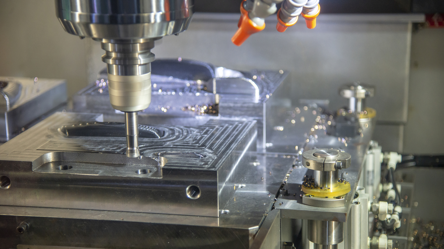

Here’s a refresher on best CNC practices engineers should keep in mind when trying to design parts that are manufacturable and cost-effective.

CNC might seem like magic. After all, an engineer need only design a part, send it through some CAM software, and then let the CNC machine do it’s thing and automatically cut a part. But that’s not quite right. There are limits on CNC machining engineers need to be aware of. For example, not all shapes and features an engineer can dream up can be created even with all the advances made in tooling and CNC controls.
Here is some advice on how to take advantage of CNC’s capabilities and avoid its limitations.
