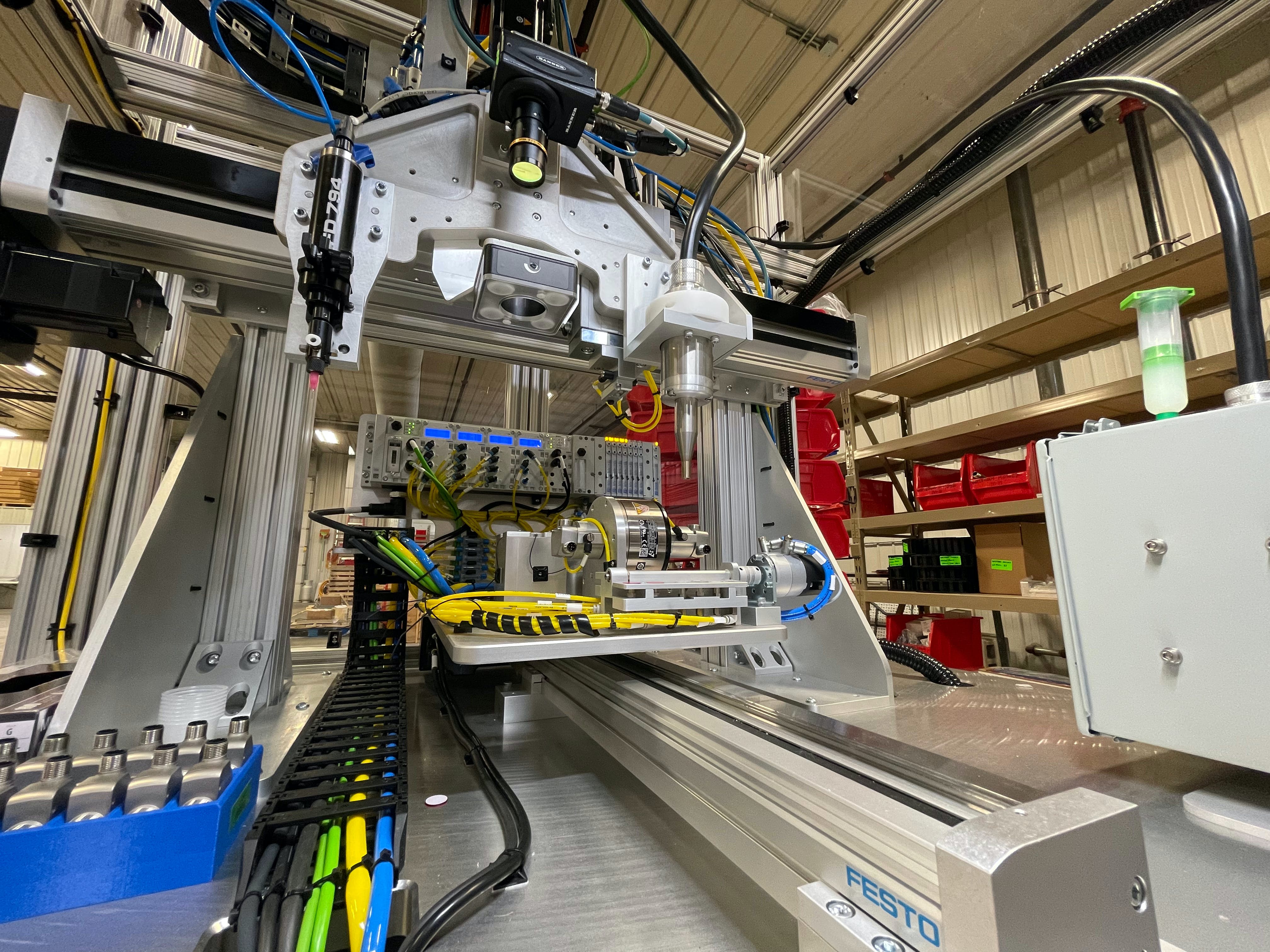

A closeup view of the Y axis, center, and the Z and X axes, above. On the Z axis from left to right are the Nordson adhesive applicator, Banner vision system and plasma gas applicator. The pick-and-place guided actuator is mounted behind the plasma applicator and is not easily distinguished. A box of die-cast housings is visible on the lower left.

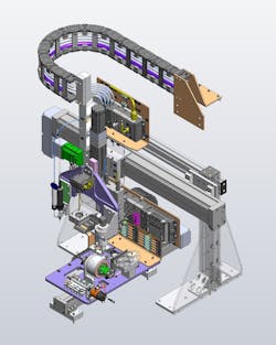

Then, the team came up with a creative mechatronic solution that relied on three ball-screw linear actuators for X, Y and Z motion, a pneumatic rotary actuator and a reliable vision inspection system.
The engineers applied a Festo EGC ball-screw linear actuator for Y axis motion. The EGC and the other axes met the ± 0.1 mm required accuracy for this application. The team mounted a platform onto the Y-axis EGC to hold the housings, covers and required equipment. Housing fixtures like the ones used in the manual process were attached on both sides of a Festo DRVS semi-rotary pneumatic drive with a Festo SRBS position sensor.
After covers were placed to the opening facing up, the DRVS rotated the fixtures to bring the next cover opening to the up position. Rotation eliminated the first bottleneck; there was no need to manually remove the housings and reposition them. The machine did the repositioning.
A Festo EGSC ball screw mini slide was used for Z axis motion. On the Z axis, the KAMP team mounted a plasma gas applicator, a Nordson adhesive applicator, a Banner iVu vision sensor and a Festo DFM pneumatic guided actuator with vacuum cup gripper. The DFM automated picking-and-placing covers, eliminating the second bottleneck. The vision system automated inspection and made it more accurate.
The X axis—also a Festo EGC ball-screw linear actuator—and the Y axis were programmed to work in harmony to trace the precise round, oval and rectangular contours of the openings and to position the applicators, vision system and pick-and-place unit precisely where they needed to be during the assembly process.
