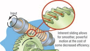

Worm gears are a power transmission standard, driving millions of axes requiring more drastic speed reductions. In this type of gearing a longer, more cylindrical worm (which resembles a screw) engages a flatter, more discus worm gear, also known as a worm wheel. The worm typically acts as the driver, and the wheel as driven axis. Unlike other gear designs, worm sets are usually unidirectional: while a worm can drive its wheel, worm systems should not be wheel-driven. This is because worm angles are often so shallow that static friction resulting between the worm and wheel holds the system in place. (Though this acts as a crude brake, it is not recommended to use the worm system as a braking mechanism — auxiliary backstops, holdbacks, and conventional brakes are the safest choice.) The worm wheel axis is at a right angle to the worm axis, and both are hobbed to mate. How teeth are cut determines the direction of rotation. The worm is typically threadmilled or rolled, while the worm wheel is hobbed to mate.

Of all worm tooth shapes, the involute is the most common. Because they are easy to manufacture, they are widely available and described in detail in AGMA and DIN standards. The worm teeth are usually thinned to fight backlash. But even after three-quarters of a century, worm gearing is not fully optimized; research continues to uncover design advantages. What is the worm’s biggest challenge? Sliding worm teeth provide smooth operation, but at the cost of generated heat. This lower efficiency (and higher rate of wear) has been addressed with increased leads. Newer vee-shaped teeth also improve performance. A slightly hollow flank profile is key: For any given transmitted torque, the large contact area minimizes the Hertzian stress (or surface pressure) on the worm. This makes for higher nominal, acceleration, and emergency- stop torques. Improved torque transmission between worm and wheel also increases efficiency, minimizing power loss, which allows for higher speeds in continuously running applications. So significant is the new design that the DIN standard in Europe is being changed to include it.
