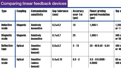

Sensors used with linear servomotors are often based on inductive, magnetic, or glass scales, or reflective (steel) tape. Each consists of a scale spanning the travel of the machine (up to 100 ft or more for tape) and a small read head that attaches to a moving member. Information from the scale, picked up by the read head, is converted to position feedback.
Linear feedback devices differ in the way information is passed from the scale to the read head. Magnetically coupled sensors – inductive and magnetic types – are usually lower in cost and less sensitive to contaminants such as cooling fluid. Optically coupled sensors – reflective tape and glass scale types – provide higher accuracy and resolution, but are more expensive. They’re also prone to failure by contaminants that block light, although (sealed) housed versions are available.
Another difference among sensor types is the dimensional stability required for the gap between the scale and read head. As a machine moves, you can count on there being an undesirable motion component perpendicular to the direction of travel. Some linear feedback devices are insensitive to this, others are not. For example, magnetic scales typically allow a 0.7-mm (0.028-in.) gap variation, while glass scales may be limited to less than a third of that. If the machine will see significant temperature changes, thermal expansion and contraction will also have an effect on the gap.
Accuracy is another consideration. Since there are no gearboxes or pulley-and-belt sets with linear motors, accuracy depends only on the tolerances of the machine and feedback sensor. Glass scales are top performers here, offering accuracy as good as 500 nm measured over one meter of travel.
Resolution is also important, affecting accuracy as well as noise. Servo loops usually hold position to within two or three counts of sensor resolution, so the lower the resolution, the less accurate the system. Low resolution also translates to noise, as it produces irregularities in the position signal which generate velocity, and hence, current spikes. Resolution as fine as 10 μm can cause audible noise, as we will see in the Lab session.
Fortunately, it’s not difficult to improve resolution. Linear sensors, like rotary encoders, produce signals that repeat as the motor moves. The length of the cycle, determined by the grating period of the scale, is related to resolution. Usually, resolution is at least four pulses per grating period, but it can be greatly increased by dividing (interpolating) the output signal into smaller parts as if it were an analog signal.
Although most encoder makers offer interpolation boxes, check your servo drive before you invest. If it accepts “sine encoder” signals directly, you may be able to interpolate on the drive, saving money and space.
A final consideration when using linear feedback devices is speed. Top speed is limited mechanically as well as electrically. For most sensors, mechanical limitations are pretty straightforward as read from a data sheet.
Electrical limitations, stemming from the ability of the read head to sense and convert “tick” marks, are a little tougher to figure out. Naturally, there is a limit on the output frequency that the read head can produce. It’s a function of mechanical speed as well as the grating period. Obviously, the finer the grating period, the faster (in terms of output frequency) the read head needs to be.
