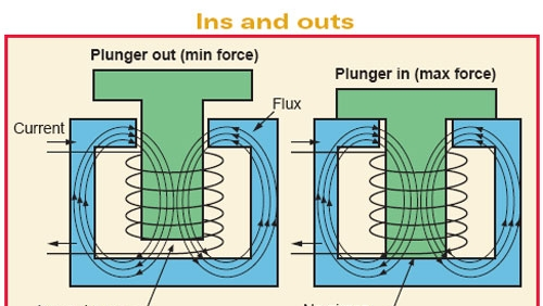

Ac solenoids are a type of electromagnetic actuator, consisting of a magnetizing coil and a plunger. Applying current to the coil produces a magnetic field that draws in the plunger, reducing the air gap as well as the reluctance of the flux path. As the gap closes, the magnetic field grows stronger, increasing solenoid force. Removing the current lets the plunger return to its original (open) position, usually with the help of a spring.
Solenoid force is a function of the field strength, which varies with plunger position and coil current. When the plunger is open, it produces the least amount of force; when it’s closed, the maximum amount. Rated force should match the load, or the solenoid may hammer itself to pieces (in the case of a small load) or burn up (in the case of a large load).
