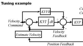

Like a PI controller, PDFF has an integral gainKVIand a proportional gain KVP. It also has additional feed-forward gain KVFR that independently controls the integral response of the system. By adjusting this gain, users can compensate for the normally small KVI term.
Suppose an application requires maximum responsiveness. Here, you don't need much integral gain, so you would set the feed-forward term KVFR high. (When KVFR is 100%, PDFF is identical to PI.)
Now consider an application on the other end of the spectrum, one that requires maximum lowfrequency stiffness. Here, you would set KVFR low, permitting a large integral gain without inducing overshoot. Don't forget that you're giving something up, however, namely responsiveness.
The majority of motion-control applications are somewhere in between these two extremes, such that a KVFR of about 65% provides generally good results.

While you're working with ModelQ, here's a method you can use for tuning PDFF loops:
1. Tune KVP
• Command a step velocity.
• Temporarily configure PDFF as a proportional-only controller by setting KVFR = 100% and KVI = 0.
• Raise KVP as high as possible without causing overshoot or oscillation.
2. Set KVFR
• 100% for applications requiring maximum response
• 65% for general applications
• 0% for applications requiring maximum low-frequency stiffness
3. Tune KVI
• Raise the integral gain until you get 5% overshoot.
You can use this same procedure for PI control, skipping step 2. Remember, PI is just a special case of PDFF, where KVFR = 100%, and it works well in applications where lowfrequency stiffness is not critical.
