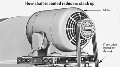

When it comes to selecting a speed reducer, most engineers think of the foot-mounted type that connects between the drive motor and driven machine via coupled shafts. But many applications including those in the grain, aggregate, and bulk material handling industries are better suited to a shaft-mounted speed reducer. This type mounts on the input shaft of a driven machine, and is held steady by an adjustable arm attached to the machine housing.
It offers several advantages over foot-mounted parallel-shaft reducers including lower installed cost, smaller size, and elimination of alignment requirements. A shaft-mounted reducer, installed with motor mount, tapered bushings, V-belt drive, and belt guard, can save as much as 40% of the cost of a foot-mounted reducer.
The reducer can be mounted in horizontal, vertical or inclined positions. In most cases, it is horizontal. The drive motor attaches to the top of the reducer housing with a motor mount, and it drives the reducer with a V-belt.
Because the motor and V-belt drive mount directly on the reducer, shaft-mounted reducer assemblies require less space than foot-mounted ones with coupled shafts. Further, the motor-belt-reducer assembly can be mounted directly onto the input shaft of the driven machine and secured by either straight or tapered bushings.
These bushings are concentrically machined to eliminate any misalignment between the reducer bore and the input shaft of the driven machine. Moreover, directly connecting the components eliminates alignment variations due to separate shafts and couplings, thereby reducing installation time and expense. Bushings allow easy installation and removal, and avoid the need to realign the reducer during re-installation. They can accommodate shafts up to 10-in. diameter.
