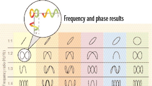

The usefulness of a test depends on how descriptive the results are. With the help of transducers, oscilloscopes are used to probe, monitor, and calibrate all kinds of systems. When set to return Lissajous figures, they graphically show the frequency and phase variations between compared signals. That’s essential to seeing the whole picture for time-variant situations, because only complex-valued results express the instantaneous relative movement of monitored points. A parametric equation, the Lissajous curve is a two-dimensional function described by a pair of equations — x=cos(nt), and y=sin(mt+a) — plotted against one another to visually reveal system relationships.

A: Calibration. Based on the idea that the nonlinearities of devices contain useful information, outputs from twin encoder detectors can be plotted against one another to reveal sensor miscalibration. Potato-shaped plots imply imperfect alignment of the light source, encoder disc, and/or photodetectors.

A: A system’s natural period is excited when the Lissajous figure closes. With little damping, the figure can be extremely sensitive to resonance, even to 0.1%. This means that measuring the isolation caused by faults provides a very sensitive equipment malfunction check. But more damping is often desirable to reduce settling times. To determine the damping constant, the phase angle is measured for different periods. If large phase angle changes occur with small driving frequency changes, then there is little damping.
