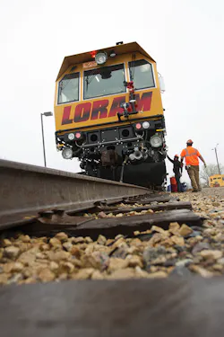

Loram is a railroad maintenance company that was experiencing downtime with its automated rail grinders due to a lack of historical or real-time data. However, new software called FactoryTalk offered remote access and documentation that improved data collection. As a result, technicians were able to reduced grinder downtime. (Courtesy of Rockwell Automation)

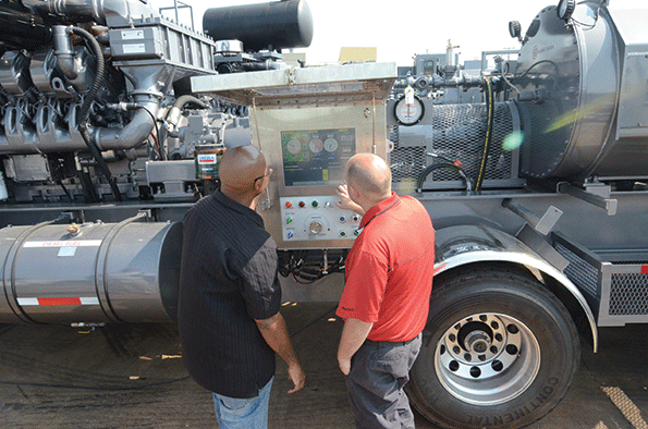

M.G. Bryan, a firm that provides heavy equipment in the fracking industry, needed a scalable way to manage vehicles in the field. Using relevant data from each truck, Rockwell used Microsoft’s cloud to monitor vehicle and fleet performance. It lets M.G. Bryan offer after-market services, such as preventative maintenance alerts. (Courtesy of Rockwell Automation)
