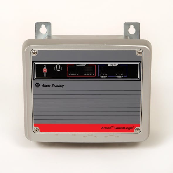

1. Allen-Bradley’s Armor GuardLogix controller from Rockwell Automation is a decentralized safety controller that can help reduce wiring time and startup costs.
Driven by improved environmental ratings, plug-and-play connectivity, on-board diagnostics, and modular wiring connections, a decentralized approach involves placing industrial automation controls and hardware closer to an application or onto a machine rather than housing them in a remote cabinet.
During the design process for a centralized approach, machine builders traditionally require significant wiring and labor to connect machines with control cabinets. Using pre-tested wiring assemblies and placing components on the machine can help reduce these costs and improve the machine builder’s time-to-market. In fact, assembly costs for machines that use decentralized technology can be up to 30% lower than conventional methods, according to a study conducted by a consortium of European manufacturers and technology groups. In some instances, the decentralized approach reduced installation time as much as 50%.
Nick Mercorella, a plant engineer at Continental P.E.T. Technologies Inc., experienced these ease-of-installation benefits firsthand. “We were able to install our entire system without ever screwing a wire down,” he says, “thus avoiding any potential miswiring and the system debugging cost associated with such problems.”
In the long term, manufacturers can use decentralized technology to help simplify troubleshooting and reduce their mean time to repair (MTTR). For example, a maintenance technician can more easily isolate problems because the cables for power and networks are from the controller on the machine, rather than intertwined with other cables from a whole production line inside a large control panel. This can lead to locating and replacing an I/O faster.
Pre-manufactured quick-disconnect cabling can help reduce wiring errors while less wiring overall can result in fewer points of failure. Quick-disconnect cabling also offers greater design flexibility to accommodate future component change-outs or system expansions.
Typically, embedded dc power with a pass-through capability enables power from a controller to other devices or modules located on a machine, which can remove the need to provide a power supply for each device and help simplify the overall system architecture.
Additionally, moving hardware onto a machine can help reduce cabinet-space demands by as much as 75% to free up valuable plant-floor real estate.
