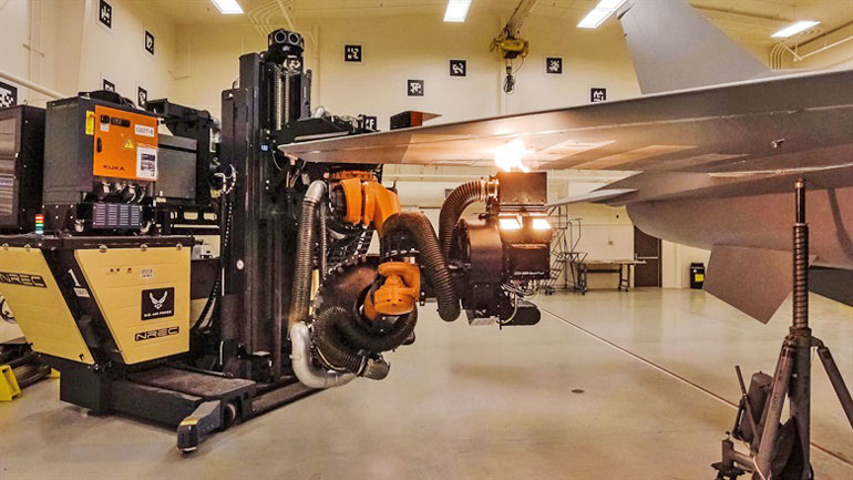

The new removal approach uses a laser-equipped robotic arm mapped individually and specifically to each aircraft that moves over the vehicle surface, essentially vaporizing paint layer by layer. The process is completely contained, so all waste materials as well as potentially harmful chemicals are vacuumed into the tool. A vision subsystem recognizes when the stripping reaches the appropriate stopping point.
The newly-approved Robotic Laser Coating Removal System vaporizes paint off an F-16 in a self-contained process that significantly reduces environmental hazards to maintainers. (Photo courtesy of University of Dayton Research Institute/Dale Jackson)
It’s a completely automated process that removes the direct human element, both in terms of error and exposure. Instead, operators guide the effort from a computer console in a nearby control room.
