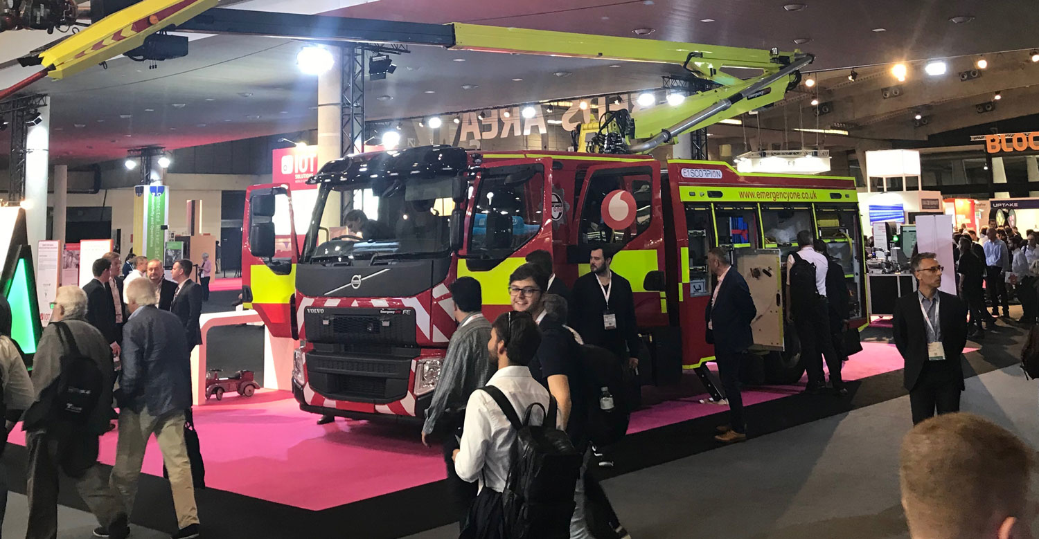

The next IoT solution at the show wasn’t as hidden: Parked right in the middle of the event space was a big red firetruck. It was the third test bed at IOTSWC. A smart fire truck developed by Emergency One together with Vodafone, it was equipped with a set of solutions that allow for the automation of a series of tasks in the control panel. While RFID tags, sensors, and hardware ensured all the vital equipment is on board, water sensors measure tank capacity and how much water was used in an incident.
As just one of the test beds, the connected firetruck proves that is it’s necessarily about the technology but how you use it to solve a problem that will yield new innovations.
The vehicle can also report when the blue lights and sirens are on, ensuring that the teams are covered from an insurance perspective. When required, the data collected from all the sensor points on the vehicles means a post-event report can be created centrally showing who was on board, how long an incident was attended for, and other data required.
Emergency One has established a key set of requirements that rescue workers need. As such the dashboard within its fire engines can now be configured to carry out a number of tasks automatically. If vehicles also had the Li-Fi technology on board, it could alert drivers that there is an emergency vehicle trying to get through even if the radio is up and they aren’t paying attention to their mirrors. If technology like this could be adopted in all vehicles, perhaps sirens and lights will not have to be so loud or bright, helping to quiet city environments.
