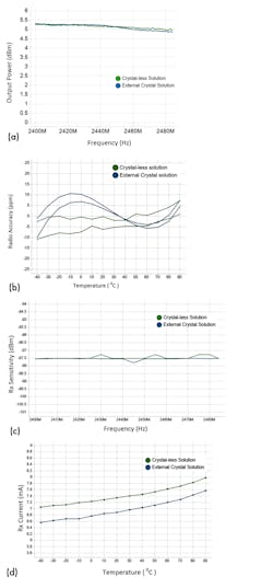

The Rx sensitivity chart compares the BLE 1Mbps mode receiver sensitivity of a CC2652RB crystal-less radio to that of CC2652R using an external crystal. Receiver sensitivity is an important metric of wireless radios and requires a high accuracy reference to not degrade over operating conditions. It can be seen that the sensitivity is comparable between the two. This proves the frequency of the BAW is accurate enough to give good performance. The RV Current chart compares the BLE 1Mbps active-mode receiver-mode current consumption of a crystal-less wireless MCU to that of one using an external crystal across temperatures.
The CC2652RB with a BAW consumes is only slightly more current during active receive or transmit operations. This approximate 500 µA current increase during active radio operation with CC2652RB is offset by TI’s real-time operating system software that enables BAW only when needed for radio operations. The overall increase in connection-profile current is small because most applications have high duty cycles. For example, a BLE connection has the following approximate current consumption:

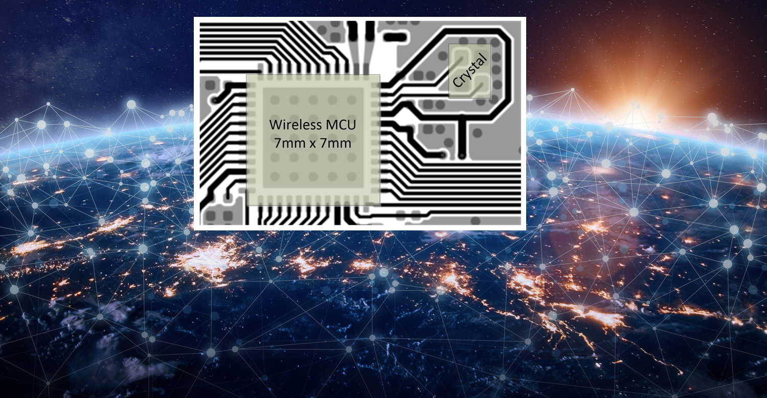

This is the printed circuit board layout of CC2652R wireless Arm Cortex-M based SimpleLink MCU reference design. Areas of the 7 × 7 mm MCU package and a 48-MHz external quartz crystal are highlighted.
