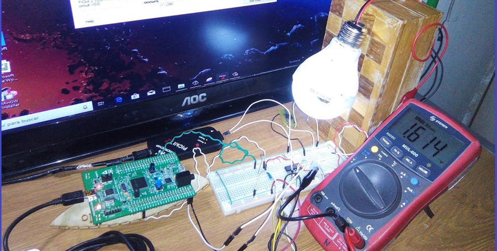

This year, the first place prize of $5,000 was awarded to Guillermo Alberto Perez Guillen, a communications and electronics engineer from Mexico, for his PID Light Meter Controller (Fig. 1). The goal of the project was to develop a system to measure and control the amount of light that a lamp emits with a feedback loop and PID controller. The project used an STM32F407 Discovery Kit board to run the PID control software, written in Ada. The project report is outstanding and really worth a read.
1. The Make with Ada first place winner developed a PID Light Meter Controller.
