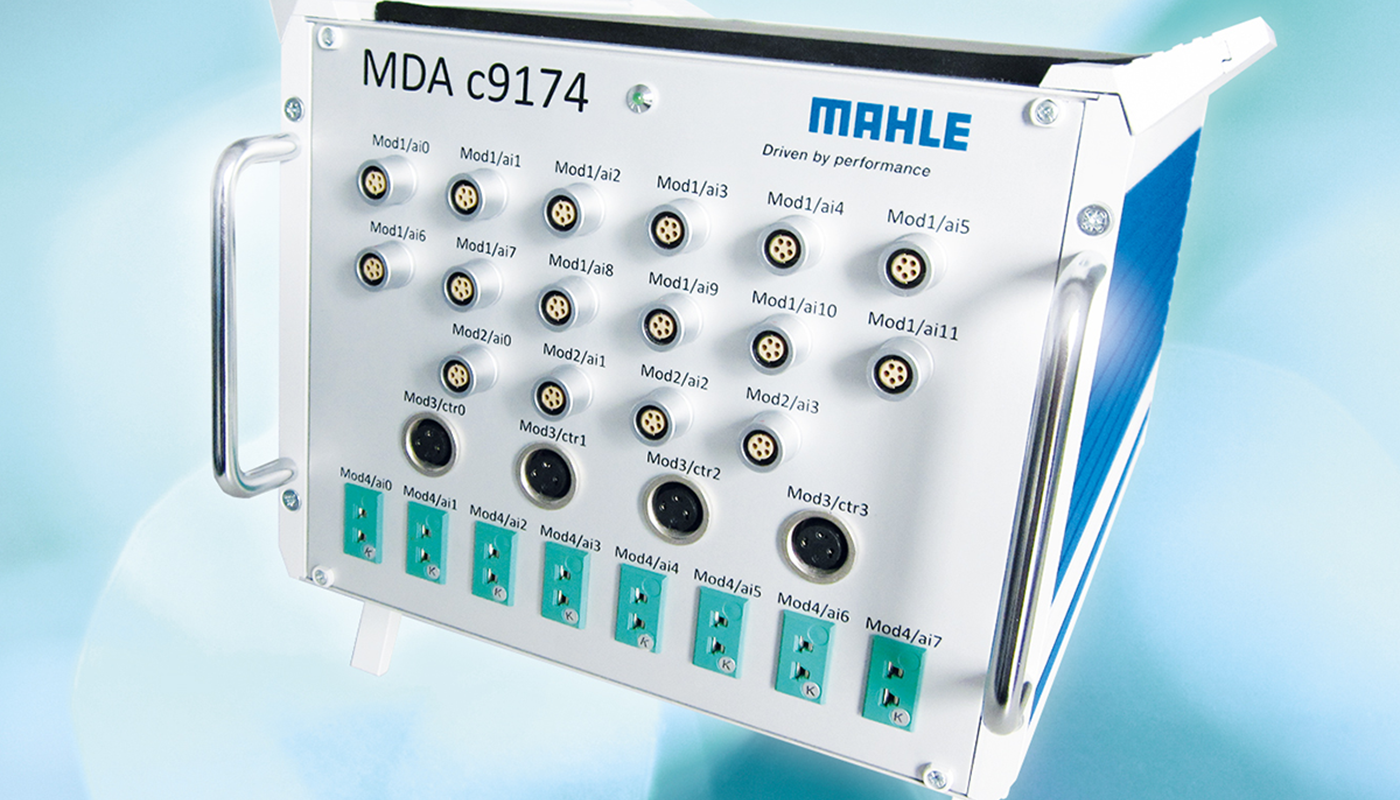

The electronics division of HEITEC has implemented the complete system integration (Level 5) for a mobile, industrial data-acquisition system of system specialist MAHLE Filter Systems GmbH, a subsidiary of the leading global automotive supplier MAHLE (see figure). The complex hardware and software system is used worldwide for mobile acquisition of measured data in the internal development of liquid filtration systems. The so-called data logger collects the required data via four integrated measuring modules (voltage, sensor bridge, counter, and temperature module) that can operate in different modes. The captured data can then be easily transferred via USB to a laptop for storage or evaluation.
The MDA c9174 mobile data-acquisition system is based on a robust 3HU HeiPac Vario module. (Source: MAHLE Filtersysteme GmbH)

After a detailed requirement analysis, the company decided to use a HeiPac Vario module (3 U, 42 HP and 310-mm depth), including the mounting plate of HEITEC’S standard system portfolio as the system basis. This was not only a cost-effective solution, but apparently well-suited based on its compact and robust all-metal enclosure construction. Due to its modular structure, the housing family is ideal for individual configuration and customization, and it allows for a high packing density. The sidewalls and transverse profiles consist of extruded aluminum profiles, while the corner elements are made of robust die-cast zinc. Sidewalls, side panels, horizontal rails, and threaded strips are also included with standard delivery. The front panel and rear wall were designed by HEITEC according to the customer’s corporate design specifications.
Which factors influenced the design of the packaging and the electronics during the next phase of the integration?
The front panel got two front handles to protect the measuring sockets and to enable better handling. The front panel carries the connectors for the sensors connecting to the four modules and the power LEDs. Furthermore, corner plates were installed for use as a mobile housing and handles were mounted for ergonomic transport. The HEITEC cover plate was also equipped with grab bars. On the back there’s a switchable combination module for the power input, a safety socket including a cover for the power supply, a USB port for the laptop connection, and a fastening device for the external power supply.
To protect the cover plate against contamination, it’s covered by an oil-resistant protective rubber. On special customer request, the 230-V connection of the power-supply unit to the socket, and each 24-V power supply of the measuring modules, were conceived. In addition, a rear-mounted terminal for the complete grounding of the system as well as a special suspension for a laptop power supply is available. This guarantees the easy connection of a laptop for data processing.
The protection against external malicious influences also had an impact on the technical inner-life of the system. To prevent dirt from penetrating into the housing, the use of fans was deliberately not considered. This despite the required 230-V power, an ac-dc power supply, and an internal 24-V power management for the components delivered by the customer, quite literally on the “working” probes. In view of electromagnetic compatibility (EMC) and heat regulation, it was carefully considered to position the components in appropriate distances to ensure passive heat dissipation for the entire system.
