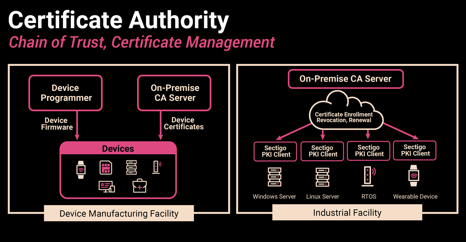

Establishing strong device identity. A strong device identity is necessary for secure communications and protection from counterfeit devices. Certificate-based authentication using PKI (public key infrastructure) is a proven, scalable way to set up a device identity across a wide range of domains and is well-suited for IoT.
Certificate issuance and management can be automated, eliminating manual processes and minimizing errors. Certificates eliminate the inherent problems of password-based authentication and other weak authentication mechanisms. Used this way, digital certificates give users strong and effective authentication. Devices also reliably authenticate other legitimate devices, preventing unauthorized communication with rogue devices and unauthorized systems.
If the device does not have a valid certificate, it is not allowed onto the network. Although counterfeiters might steal device firmware to make cloned devices, they cannot duplicate valid certificates. Certificates are unique to each device signed by a Certificate Authority (CA). Counterfeiters cannot access the CA or duplicate the PKI system to generate certificates. Manufacturers who use certificate-based authentication with a properly implemented PKI system will stop counterfeiters from being able to pass off their devices as genuine.
Automated certificate issuance and management are critical to handle the large number of IoT communications and devices. Methods of automating PKI will include a CA server supporting enrollment protocols and device-side SCEP/EST (simple certificate enrollment protocol and enrollment over secure transport) clients. Together, these elements can be used to build a fully automated process that lets devices securely request new certificates, validate certificates, and recognize when certificates are revoked. Automating CA also puts in place certificate chaining support to ensure all certificates are properly validated.
Strong device identity starts by securely putting certificates into the device during manufacturing and then actively managing the certificates through the entire life of the device.
Automating CA also manages certificates over the entire lifecycle of the device. The process starts with putting certificates into the device during manufacturing to prevent counterfeiting and cloning. When devices are purchased and installed on a network, they go through an onboarding process. During onboarding, they are first automatically validated using the certificate installed during manufacturing, then issued a new certificate for use on the network. The certificate can later be revoked when the device is decommissioned.
If the device lacks a valid certificate, it is not allowed onto the network. Although counterfeiters steal device firmware to make cloned devices, they are cannot duplicate certificates. Certificates are unique to each device and counterfeiters cannot access the CA or duplicate the PKI system to generate certificates. Without the PKI, they can’t pass off their devices as genuine.
