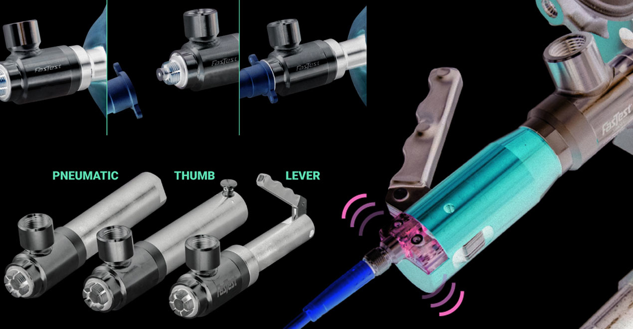

One of FasTest’s most popular products, the FasMate FN series, provides an efficient way to seal ports with female threads. The connector uses a split collet design that let the jaws collapse, allowing for an instant connection that is safe up to 5,000 psi. There’s no need for a wrench, pipe tape, sealant, or any other antiquated sealing method. The operator simply opens the connector, inserts it into the port, and closes it using one of three methods: lever, thumb valve, or pneumatic.
The lever requires that operators simply squeeze the handle. Both the thumb and pneumatic methods use air pressure to control the connector; one uses a built-in thumb valve and the other has an air-line port opened using a foot switch or other means.
All three methods collapse the collet so the connector can be inserted into a port. The collets’ jaws and center shaft are hardened stainless steel, which provides a balance of strength and wear characteristics. If the parts were too hard, they would be brittle and fracture after the repeated stress of high-pressure tests. And if they were too soft, they would wear too quickly. The stresses are distributed between the shaft and collets to ensure they work together. The shaft and collets are designed so that the end of the shaft is wedge shaped and pushes against the collets’ inner diameter, forcing them outward. This means the connector pulls itself into the port as pressure increases, making it safer and more effective during high pressure tests.

To meet manufacturers’ increasing needs for data points, FasTest added smart technologies into FasMate. Connection Verification (CV), for example, lets manufacturers verify successful, safe connections have been made before starting a leak test. It measures piston travel, and that information alerts operators when something has changed. It consists of a potted circuit board containing an LED to alert operators of good connections.
The connector can be configured in either a discrete (sinking/NPN or sourcing/PNP) or analog output. The discrete output lets operators know whether or not the main seal is in the calibrated range, and thus whether the connection was successful or not. Connectors with the analog output are particularly powerful because they communicate in real-time what is happening to the main seal. They work at either a 0 to 5 V or a 5 to 10 V range.
Regardless of the output, discrete or analog, the circuit board can be calibrated to show when the piston has moved to the correct position and alert both the operator and leak-test system that the connector is properly sealed, and the test can be safely run. This helps eliminate false failures.

The connector can be activated pneumatically by a foot switch, by a thumb switch, or by a lever. Any of these three methods opens and closes the collet that makes a tight connection with an internally-threaded female connector hooked up to the device being tested.
