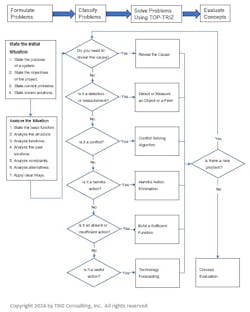

TOP-TRIZ Problem Solving
TOP-TRIZ classifies formulated problems into the following six classes and provides algorithms to develop exhaustive set of ideal solutions to each of them. The classes of problems are an unknown harmful function, a need to introduce or improve detection or measurement, a conflict, a harmful function, an absent or insufficient function and a need to invent next product generation.
TOP-TRIZ classifies formulated problems into six distinct classes: an unknown harmful function, a need to introduce or improve detection or measurement, a conflict, a harmful function, an absent or insufficient function, and a need to invent a product’s next generation. For each of these classes, TOP-TRIZ provides algorithms to develop a comprehensive set of ideal solutions, ensuring that all possible avenues for innovation are explored and addressed systematically.
A problem is classified as an Absent or Insufficient Action if there is a need to introduce a new function or find a better way to perform an existing function. Solving this class of problems is guided by a method called Build a Sufficient Function. The key to this method is a guide to introduce a missing action and identify one or more possible sources of the action among available resources. A list of most used fields (the physical nature of actions) helps to overcome preconceived notions and background barriers (psychological inertia) in the selection of possible nature of the action.
A problem is a Conflict if an attempt to eliminate a harmful function deteriorates or even disables a useful function. The TOP model of a conflict consists of these two functions. TOP-TRIZ Conflict Solving Algorithm is the next generation of Altshuller’s ARIZ, a step-by-step guide to developing breakthrough solutions to a conflict while eliminating the harmful function completely without any deterioration of the useful function and even sometimes with the improvement of it as well. It consists of six steps.
The first four steps—each one or two simple sentences—lead to identifying three physical contradictions behind the conflict. The fifth step applies all six ways to separate physical contradictions. Most conflicts could be solved by using just Step 1, resulting in Physical Contradiction 1, and Step 5 for its separation. Step 6 guides the TOP-TRIZ user to state subsequent problems, if any.
The Conflict Solving Algorithm Flow Chart
A problem is classified as a Harmful Action if it results in a harmful or not needed product. Harmful Action Elimination methods guide a TOP-TRIZ user to eliminate a harmful function and, if possible, leads to turning the harmful function into a useful function.
A problem is classified as an Unknown Harmful Function if its action is unknown. The method for revealing the root causes of a failure is based on inventing ways to recreate the failure. Here the TOP-TRIZ user turns the problem on its head, pretending that the harmful product of a failure is a desired product. This allows the user to apply all of the power of TOP-TRIZ to invent potential mechanisms of the failure.
A problem is classified as a Detection or Measurement if there is a need to introduce a detection or measurement or improve existing ones. Since in most cases detection or measurement is needed to control an important process, the best approach is to eliminate the need for detection or measurement. If it is not possible, the method guides to build the most effective detection or measurement system.
A problem is classified as Technology Forecasting if there is a need to invent next product generation, formulate new problems for further improvement of an existing system, maximize utilization of new solutions, develop a road map of innovation and marketing strategy, or develop concepts for a patent umbrella.
