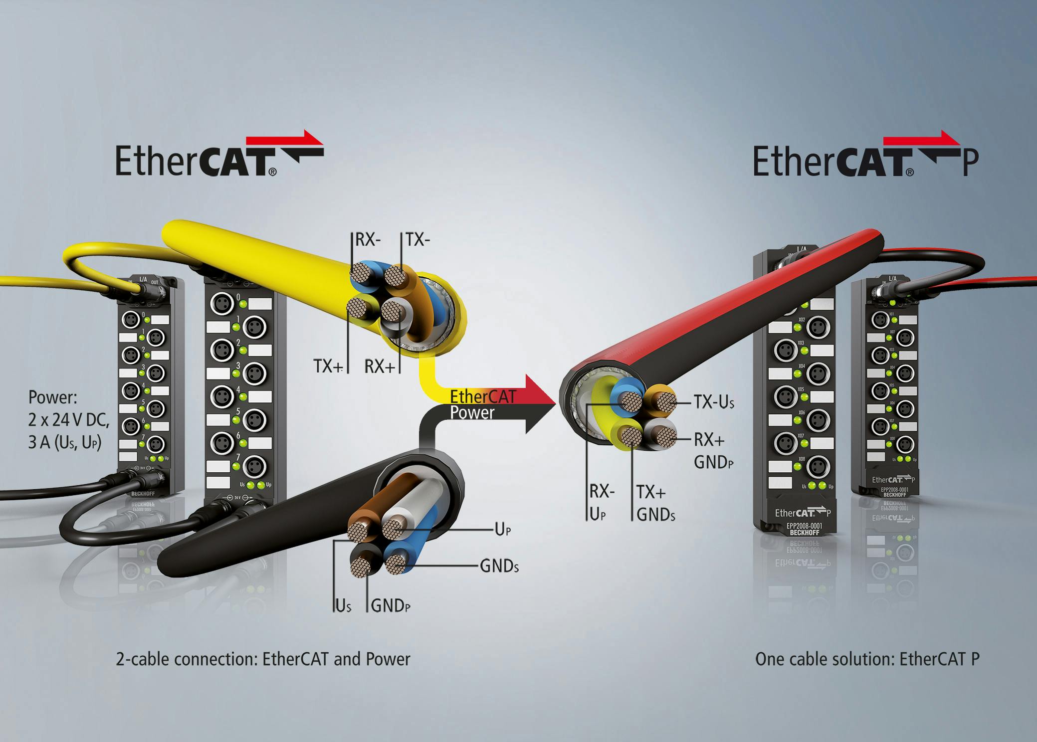

Uncompromising Performance: EtherCAT P
SPE isn’t the only Ethernet-based protocol looking to integrate field level devices into the rest of the automation network. EtherCAT P, an extension of the EtherCAT protocol standard (IEC 61158-1), also provides 24V DC of power, but over a standard twisted pair Ethernet cable. More precisely, EtherCAT P provides two electrically isolated power sources—Us for system and sensor supply and Up for actuators—each delivering 24V DC and up to 3A to EtherCAT field devices. On the data side, EtherCAT P cables provide the same full-duplex 100 Mbit/s capacity as standard CAT 5 Ethernet.
As to topology, EtherCAT P allows for those common for bus systems (star, ring, tree, etc). Layouts begin with an EtherCAT master connected to either an EtherCAT P coupler (for a star layout from the panel) or an EtherCAT P junction box (for a linear or tree layout in the field). Both a coupler or junction box is where a 24V DC supply adds power to the EtherCAT P segment of the network.
Beyond this point, EtherCAT P “hubs” can be daisy-chained to extend the network. Junction boxes and hubs feature multiple M8 connector ports specifically designed to prevent a non-EtherCAT P worker from being plugged in. If a power boost is required, additional junction boxes can be installed anywhere along the cable run.
An EtherCAT P network can address up to 65,535 devices, each of which can transmit process data from 1 bit to 64 kbyte. In addition, EtherCAT P retains the capabilities of standard EtherCAT including cycle times of less than 100μs (microseconds) and distributed clocks for precision synchronization of less than 1μs.
While EtherCAT may sound similar to Power over Ethernet (PoE), Beckhoff Automation Product Manager Azad Jafari points out the two are distinctly different.
“Ultimately, EtherCAT P is deterministic; Power over Ethernet is not,” he says. “In addition, with PoE you layout the typology through switches. With EtherCAT P, there are no switches; you can daisy-chain devices so you can go from the main controller to a EtherCAT P device to a sensor. This way you can eliminate the time delays inherent in the use of switches.”
Although EtherCAT P boasts impressive performance, it should be noted that, as yet, it’s utility favors actuators rather than sensors. According to the EtherCAT Technology Group, there are very few EtherCAT P enabled sensors on the market and they are produced by only a handful manufacturers.
