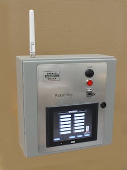

The entire control system including the PLC, the HMI, and other ancillary components is housed in a small enclosure, saving money and space. (Courtesy: Parker Boiler)

The HMI was programmed with accessible graphics and menus to make the Parker system easy to setup and monitor, with virtually no operator training required. The screens are self-explanatory, and Parker employs password-protected screens so an operator does not inadvertently change a critical setting. The alarm log, data log, and trend display features of the HMI are all utilized to provide information needed for troubleshooting and preventive maintenance. The entire automation system for control of up to eight boilers is housed in a 16-in. square enclosure that is just 8 in. deep.
