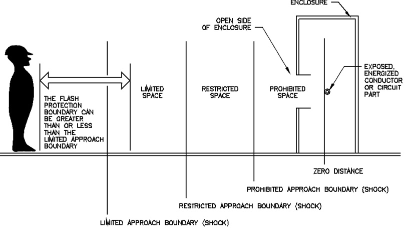

  • National Fire Protection Association (NFPA) 70E-2015: “Standard for Electrical Safety Requirements for Employee Workplaces.” The intent of NFPA 70E regarding arc flash is to provide guidelines that will limit injury to second-degree burns, including:
A flash hazard analysis shall be done in order to protect personnel from the possibility of being injured by an arc flash (Flash Protection Boundary and Limits of Approach).
Only qualified personnel who possess the skills, knowledge and safety training to recognize and avoid hazards shall be permitted to work on electrical conductors or circuit parts.
Personal Protective Equipment requirements designed and constructed for the specific part of the body to be protected and for the work to be performed. NFPA 70E, Annex H and Table H.3 (a and b).
1. Illustration of approach boundaries (W.Va. University). NFPA 70E Tables 130.4 (C) (a and b) define approach boundaries and work spaces.
