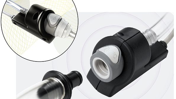

Connection-related problems that were overcome in actual fluid-handling equipment took advantage of communicating couplers.
Machines that use fluid-handling systems can take advantage of communicating couplers (see "The Rise of Intelligent Fluid Connectors"). Below are three connection-related problems that were overcome in actual equipment.

Upon investigation, the manufacturer found that customers had switched to a third-party ink supplier that was refilling the company’s branded containers with cheaper, inferior inks. To prevent ink substitution and protect ink sales, equipment performance, and brand reputation, the manufacturer equipped printers and ink containers with communicating fluid connectors. Users now instantly know when a container with non-approved ink connects to a printer. Machines are programmed to either alert the operator or prevent printer operation.
Each ink container comes equipped with an RF read/write tag that communicates data about its color, authenticity, date of manufacture, and remaining volume. With these connectors, the printer manufacturer protects its ink sales, facilitates warranty management, and supports its premium brand position. Users enjoy trouble-free machines that eliminate bad print runs.
