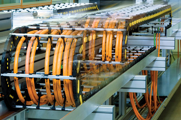

Choosing the best cable for an industrial application is one of the most critical design decisions of any complex automated system. Designers often select cables as an afterthought – not giving enough time to make a well informed decision. As the lifeblood of the system, cables and wires are vital to transmitting power and sending control signals and data across wide expanses in a timely and reliable manner. Here we take a look at some of the most important factors to consider when specifying industrial cable.
Wires and cables intended for use within cable tracks are subject to enormous loads. Especially in highly dynamic applications, several factors should be considered when choosing the right cable—durability, reduced weight, a small minimum bending radius and the ability to fit within tight spaces. Many of today’s automated production environments must meet rigorous productivity benchmarks, often requiring components to handle speeds of 5 m/s and acceleration of 50 m/s2, along very lengthy paths. To meet these demands, every component in the system must be optimized to work together, including the cable, wiring, cable tracks and carriers.
