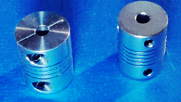

For light-load applications a setscrew coupling can be quick and cost-effective. Products like Loctite can help prevent the setscrew from vibration-induced loosening. It’s suggested that setscrew couplings be used with only low loads and applications that will not see any shock loading.
Two different types of couplings give options for various applications. The setscrew is easy to install and cost-effective, but the clamp is typically better able to handle shock and larger loads.
