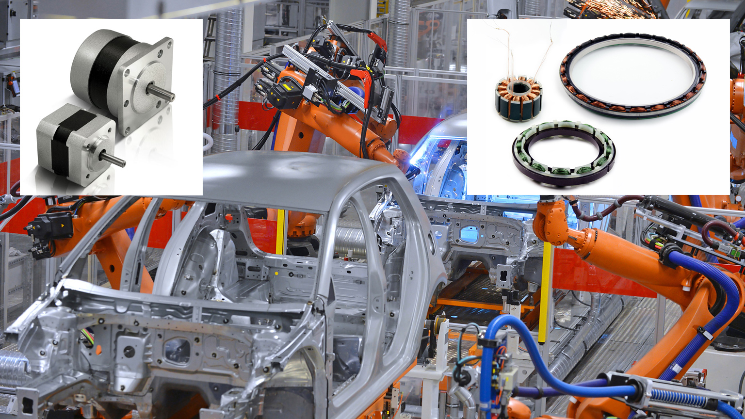

Hybrid lidars can be made smaller another way: by equipping them with brushless DC (BLDC) motors. These motors come in various sizes and shapes. Engineers are familiar with NEMA size standards such as NEMA 17 or 23. Often BLDC motors are readily available and can provide a great off-the-shelf fit. This approach relinquishes the possibility of creating something that is smaller, though, since it’s more of a one-size-fits-all approach, especially while trying to minimize the size of the overall sensor.
One pathway to smaller, lighter BLDC motors is to eliminate unnecessary components. When it comes to motors, BLDC versions lend themselves to this process. For example, most of off-the-shelf BLDC motors are structurally and mechanically self-supporting with the rotor suspended inside the stator from end caps at both ends. But if the end caps are eliminated, the motor can still be connected in what is called a frameless motor.
Frameless motors eliminate more than just the endcaps. They also do not need any mounting supports, plates, or brackets. All structural and mechanical supports needed can be part of the lidar. In such a design, the stator and rotor can be seamlessly accommodated, reducing size without sacrificing performance.
Aerodynamics and visual styling also play major roles in vehicle design. For automotive engineers and designers, it is much easier to incorporate a wider and flatter shape on the exterior of a car or truck than a tall, narrow shape. Frameless BLDC motors lend themselves to slim profiles, making them a good fit for a streamlined vehicle. So, a frameless motor can have a large diameter to offset the lower height and still get the same performance of a taller BLDC motor. The laser transmitter and receiver, which will be spinning, can be mounted inside the rotor with some of their components down inside the motor’s stator. Both of these options reduce the lidar’s height for a more aerodynamic shape.
The additional benefit of going with a frameless design is that standard-sized motors are no longer a constraint. This means designers have greater opportunities to explore various motor shapes and sizes. For example, the motor can be designed to fit the application rather than forcing the application to fit the motor. This gives engineers the freedom and flexibility to design lidars with the smallest possible footprints.
