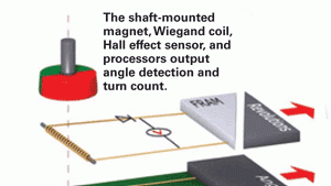

Magnetocode (MCD) absolute rotary encoders from FRABA Inc.'s POSITAL unit, Hamilton, N.J., employ dual technologies for super-accurate positional feedback — a two-axis Hall effect sensor that measures change in the magnetic field and reports angular measurement to the control system, and a rotation counter based on the Wiegand effect. Measurements occur without the need for external power, so that changes in absolute shaft position (number of turns plus angular displacement) are registered and reported correctly to the control system, even if power is lost.
One potential limitation of the basic MCD design is that key measurement components (namely the permanent magnet) must be mounted at the device centerline, preventing a true hollow-shaft encoder design. The new MCD configuration places the encoder unit beside the shaft: A hollow-centered bushing fits over the machinery shaft — like a ring around a finger — and sits beside the encoder, with the two components connected by gears inside a rectangular case.
