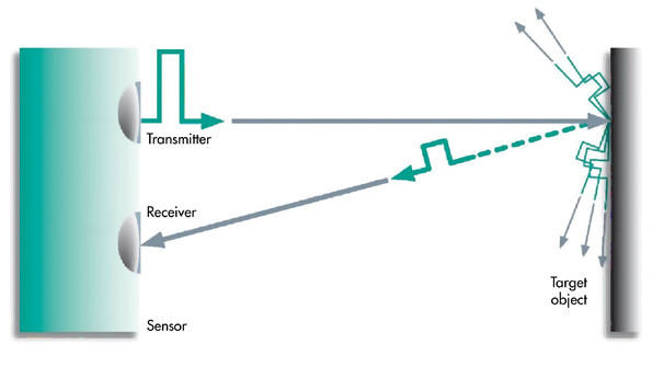

Pulse-ranging-technology sensors emit short bursts of high-intensity laser light at up to 250,000…times/sec. The light intensity of a PRT sensor can be up to 1,000× greater than that of a phase-correlation sensor, which uses an emitter that is on continuously.
The light bursts travel to an object or reflector and then reflect back to the sensor’s receiver, or light-sensitive element. The sensor measures the time lapse from the emission of the light burst to the detection of the burst by the sensor’s receiver element. This time is then used to calculate the distance from the sensor to the detected object:
s = c × tl/2
Where s = distance measured in meters
c = speed of light in air (299,792,458 m/sec), and
tl= measured elapsed TOF of the light burst in seconds.
