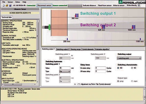

There are caveats: Scrapyards are notoriously noisy, and acoustic interference can degrade output. Plus, anything can end up as scrap, and some materials and shapes deflect or absorb ultrasonic pulses. The solution is to avoid mounting ultrasonic sensors directly over processes being monitored. Instead, mount them at a slight angle. In addition, use units with filtering algorithms and detection modes. These widen or narrow the sensor beam to match the monitored area’s dimensions — to focus on a scrap container’s opening, for example.

One way around this is to strobe transducers through a sensor-to-sensor interconnection or external controller. This is called multiplex operation. When sensor A is active, sensors B and C are paused. The drawback is that incrementally polling several sensors slows overall response time.
Where speed is a concern, a better approach is synchronized operation. A controller polls sensors simultaneously, and the first to return a particular echo “wins.” This approach leverages the fact that the perpendicular return path of a sensor’s echo is always shorter than path of reflections from adjacent target sensors. System response time in synchronized operations is usually identical to those of a single-sensor installation. In addition, sensors can be spaced closer together for more-reliable scanning of the application’s objects. For a detection range of up to 6,000 mm, synchronized operation can have ultrasonic sensors installed as close as 25 m. For a detection range of up to 2,000 mm, ultrasonic sensors can be as close as 8 m.
