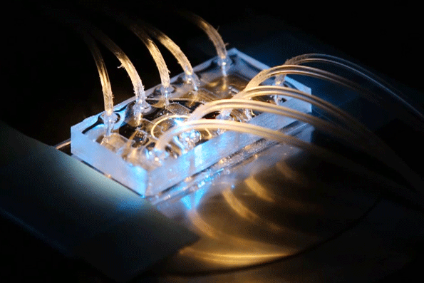

This microfluidic device is similar to the one used for the new high-throughput sorting system.

The new additive increased fluid flow, but the relatively soft materials used to make microfluidic channels and devices would not withstand the higher pressures. So the team had to develop a more-rigid microfluidic-handling device out of epoxy that was still transparent.
In the prototype device, fluids travel through channels 50-µm wide at more than 400 mph. Cells and other particles are forced to the center of the fluid flow and travel single file through the channels. A laser emits flashes measuring 10 billionths of a second to illuminate particles, letting the team image the size, shape, and orientation of cells.
