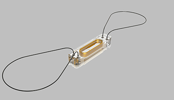

The CardioMEMS sensor is the size of a dime and is implanted in the pulmonary artery to help monitor increases in pressure The wire loops seen above are made of nitinol and extend from each end of the sensor This stabilizes the sensor in the implant location

The sensor, CardioMEMS HF System, was developed by St. Jude Medical center. The sensor does not require a battery and can be implanted directly into the heart to monitor the pulmonary artery. It is about the size of a dime and is placed inside the heart via a minimally invasive procedure. The miniaturized wireless sensor can be implanted using a catheter-based procedure. The procedure itself is about an hour long and requires no overnight stay. Patients can resume daily activity as the sensor goes unnoticed within the patient’s heart.
The sensor detects increases of pressure in the pulmonary artery. The rise in pressure is a preliminary sign of heart failure that can be detected prior to symptoms presenting themselves, such as shortness of breath, requiring immediate medical care. The sensor is hermetically sealed and contains an inductor coil and pressure-sensitive capacitor. The inductor coil and capacitor create a resonant circuit at a specific frequency. The blood pressure affects the resonant frequency and as blood pressure changes so does the resonant frequency. The external measurement system tracks the resonant frequency wirelessly and determines the pressure in the pulmonary artery.
