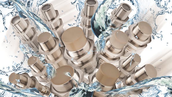

Courtesy AutomationDirect
These presence sensors from AutomationDirect use photoelectric, inductive, capacitive and ultrasonic technologies for applications in a wide variety of industrial environments.
