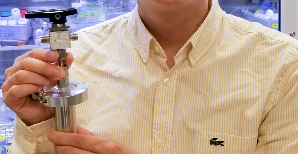

Wei Chen, a researcher at Stanford, holds a prototype battery that uses water and manganese-hydrogen in a water-based chemical reaction developed in the lab. (Image credit: Jinwei Xu)
