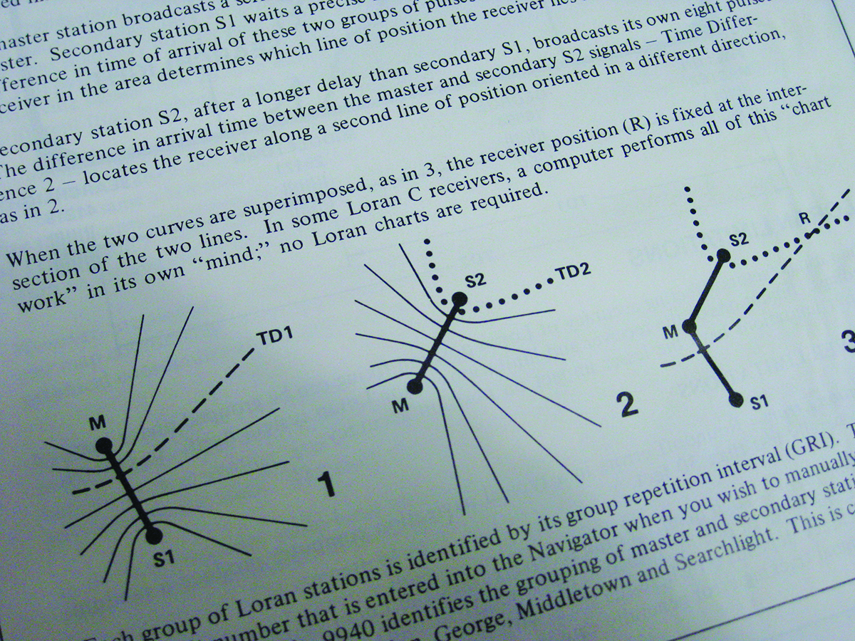

Loran — short for long-range navigation — was developed in the United States during World War II as a technically superior alternative to British radio-based positioning. In short, Loran consists of dozens of towers installed at bases all over the world that transmit synchronized low-frequency radio signals. These signals are picked up by receivers: More specifically, a given Loran receiver installed in a watercraft (or aircraft) collects synchronized Loran signals from the three towers that happen to be geographically closest. Next, the differences in the separate signal arrival times are translated into position by the receiver's computer — to locate a vessel as far as 1,500 miles away to within a few feet in some cases.

Loran is also called hyperbolic navigation, as a Loran receiver is always on a reference curve for which the arrival-time difference of two signals is constant — typically proportional to how distant towers are.
