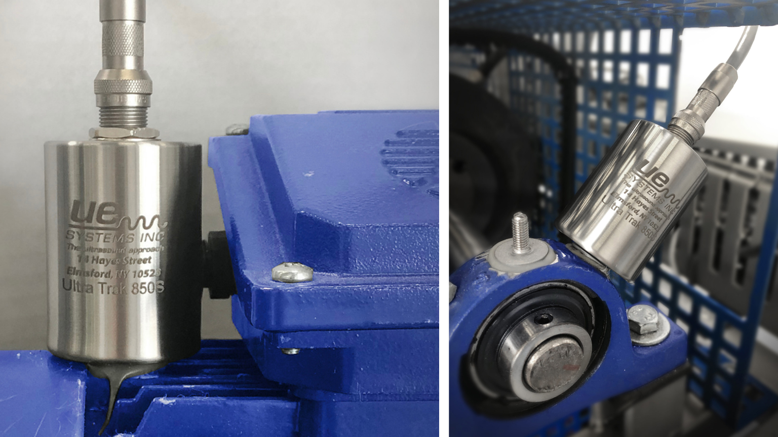

UE Systems focuses on airborne and structure-borne ultrasound, said Miller. It is a predictive maintenance tool, he said, which provides a method for detecting leaks (compressed air or compressed gas leaks), electrical inspection (including corona tracking and arcing from energized equipment), bearing condition monitoring and lubrication, and steam trap and valve testing. Alongside recent advancements in software, motion control and robotics, a range of ultrasonic inspection instruments are available for industrial environment applications.
Ultrasonic testing is good for measuring friction, impact and turbulence. Airborne and structure-borne ultrasound uses the air or a structure to listen to the condition of an asset. In essence, high frequency sound waves are used to characterize or map the thickness or internal structure of an asset. The frequency or pitch used in ultrasonic testing far exceeds the limits of human hearing, and can range from 500 KHz to 20 MHz.
An ultrasound transducer connected to a diagnostic machine is waved over the asset being inspected. A couplant such as oil may also be used to separate the transducer from the asset. The transducer sends a pulse through the object. The sound or echo is sent back to the device once it hits an interface, such as the back wall of the asset. The results are translated to a diagnostic machine and are displayed by an amplitude representing the strength of the reflection as well as the distance, which is derived from the arrival time of the reflection. The presence of imperfections is based on the amount of sound reflected.

“With COVID-19 and with the lockdowns, we started to see a bigger shift into remote monitoring,” said Miller. “That’s especially the case with our newer systems, where a cloud-based system can monitor the bearing wear effectively, but also have a single-point lubricator attached.” Technicians now receive notifications on their mobile phones alerting them that a bearing needs lubrication. And with the click of a button, they’re able to lubricate the bearing from anywhere.
