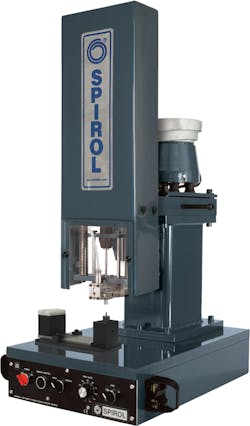

11. The CR Pin Inserter from Spirol is most commonly used to install solid pins. It is well suited for moderate to high production volumes and can exert up to 1,800 lb of installation force. Manual pin inserters are available for lower volume production.
