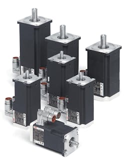

AC Servo Motors
Alternate-current (ac) motors, which function like brushless motors, target applications that require rapid and accurate response. Their design has small diameters and high resistance rotors, thus providing low inertia for fast starts and stops.
The N-Servo ac brushless servo motors from Baldor provide a design with neodymium-iron-boron magnets. Continuous stall torque ranges from 0.45 to 40 N-m, and acceleration torque from 1.8 to 160 N-m. The servo motors are 200°C moisture-resistant and designed to operate in temperatures up to 155°C. Their inertia range, 0.067 to 38 Kg-cm2, is low to attain high acceleration capability. The servo motors are not only common in robotics, but also medical, packaging, and manufacturing industries.
