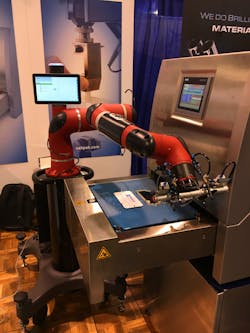

Collaborative robots are now being explored to automate certain steps in the heat sealing process for medical packaging. These robots can load trays and lids from the table top heat sealing machines, initiate the sealing cycle, and remove the sealed, sterilized package from the machine once complete. In other scenarios, they may be used to load and unload trays from a rotary heat sealing machine or pick up trays and present them to printing stations or package testing units.
The cobots can be closely situated alongside sealers and are able to navigate around the side of the sealing unit without touching it unintentionally. Immediately after the sealing process, the seal is still warm and has not reached its maximum strength. Touching the sealed area and possibly applying mechanical strain to it may compromise the quality of the seal and could impact the sterility of the medical device.
