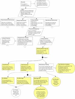

This kind of testing can result in product certification, such as per UL’s Cybersecurity Assurance Program, which was part of the initial inception of the U.S. Cybersecurity National Action Plan (CNAP). The information generated through such testing can also help to formulate an Assurance Case, such as that shown in the illustration from U.S. CERT (Fig. 7).
7. US CERT Security Assurance Case Pattern (from “Arguing Security—Creating Security Assurance Cases”)
