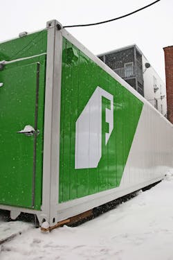

What inspired the idea to create the farm system in a shipping container?
We got started around 2009, and at the time there were only rooftop greenhouses coming into market, which was exciting. We saw a lot of initial design renderings and articles saying how farming is coming to the city and going to the rooftops. We decided to do some analysis if it was possible, and quickly realized that that was never going to happen.
The structural component—especially in Boston—of those buildings would require you to spend a quarter-million in just structural infrastructure to put it up there and then build on top of it. And these rooftop farms would not only be out of the way of local grocery stores and produce distributors, but also too complicated to implement for the average person. So, we realized that we need to take all the hurdles out of this and make it more accessible for a wider audience.
The first piece was solving structural piece, which is the framing of the greenhouse. By getting into cities, we decided that shipping containers solved all these challenges. For example, you can stack them 16-high—you know, with no load structure problems—and you can also have freezer levels of refrigeration. We realized if we can bring all these systems into this one box, that we have something that is ubiquitous around the world in every port city. There is a surplus of shipping containers not in use because they can't travel across the sea anymore. Now we have a structure that can house an environment that is stackable and modular. People can start with one and then continue to scale up.

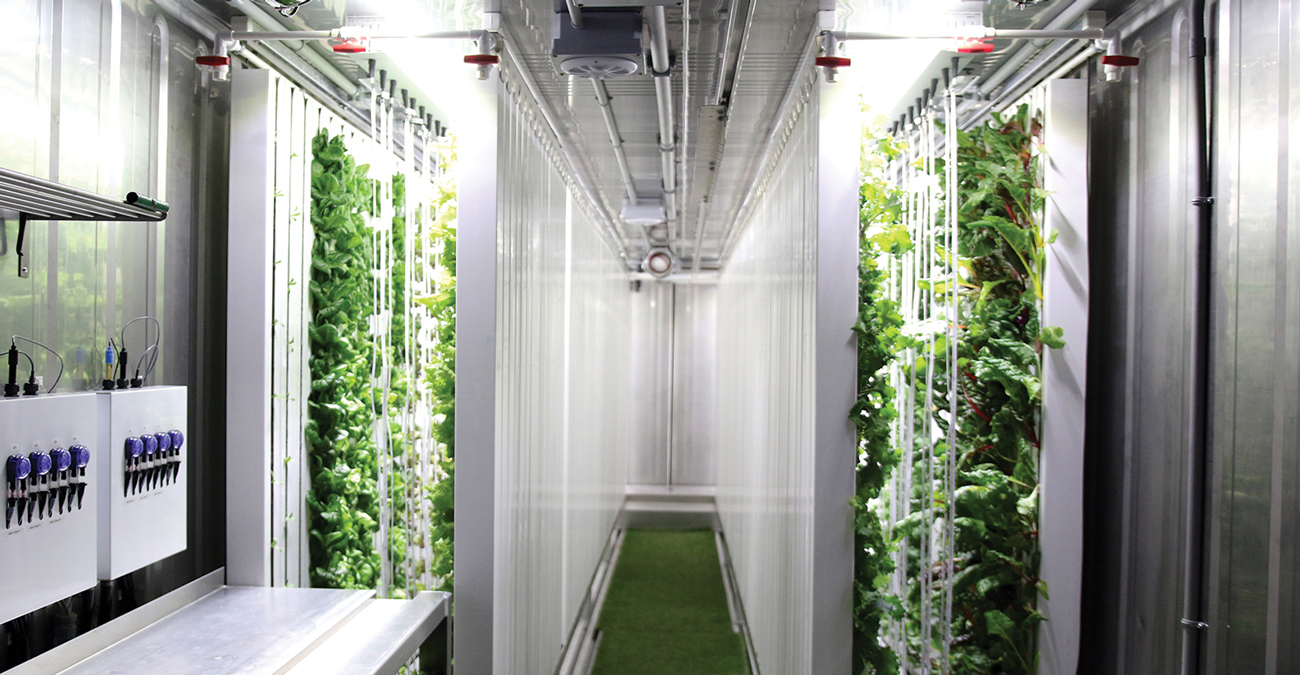

Inside the box, you are using different kinds of light waves for your photosynthesis, and you have hydraulic irrigation systems. How are you monitoring and collecting that data?
It's remarkable how much of the basics plants need, and if you’re sensing things like water temperature, electrical conductivity, and PH in the water, just those three alone have so many different variables that you can tune a plant to. If you take that and use the variables in the air like humidity, CO2, and temperature, those six main components create your rubric for different recipes for different crops. Then, take that recipe and tune it to the light with the red blue spectrum, which is the spectrum of light that plants need for photosynthesis. You can control the plant growth. We can adjust the colors to our needs.
For example, we can push more blue light to get a more purple effect from the plant or achieve a more red tip on something like red leaf lettuce. With the different schedules of temperature, humidity, and colors of light, you can increase these plant attributes. This fine tuning is exciting, because the overall goal is to develop these recipes and share them with other farmers. We can start mapping specific farming systems across a shared network, provide performance results, and release updates to everyone so they get the same efficiency.
