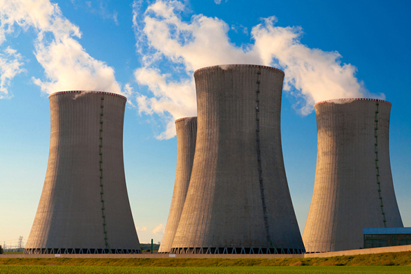

A three-phase plan to use thorium in a nuclear reactor could produce energy with less waste and more efficiently use the fuel as well.
(Image courtesy of Thinkstock)
