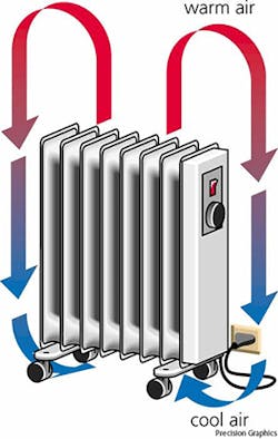

A space heater is a classic convection example. As the space heater heats the air surrounding it near the floor, the air will increase in temperature, expand, and rise to the top of the room. This forces down the cooler air so that it becomes heated, thus creating a convection current.
