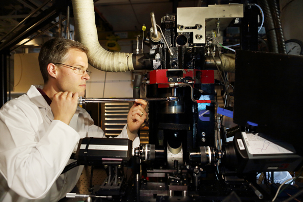

A researcher at Sandia National laboratory uses optical diagnostic techniques to uncover how pollutants are created in diesel engines and how low-temperature-combustion technology could reduce harmful emissions.
