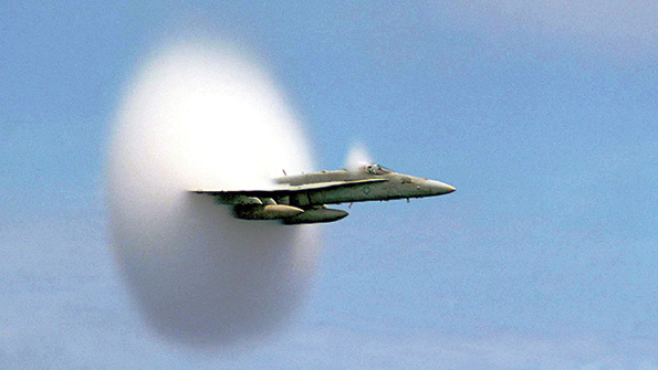

This F/A-18 Hornet is breaking the sound barrier and forming a shock wave.
