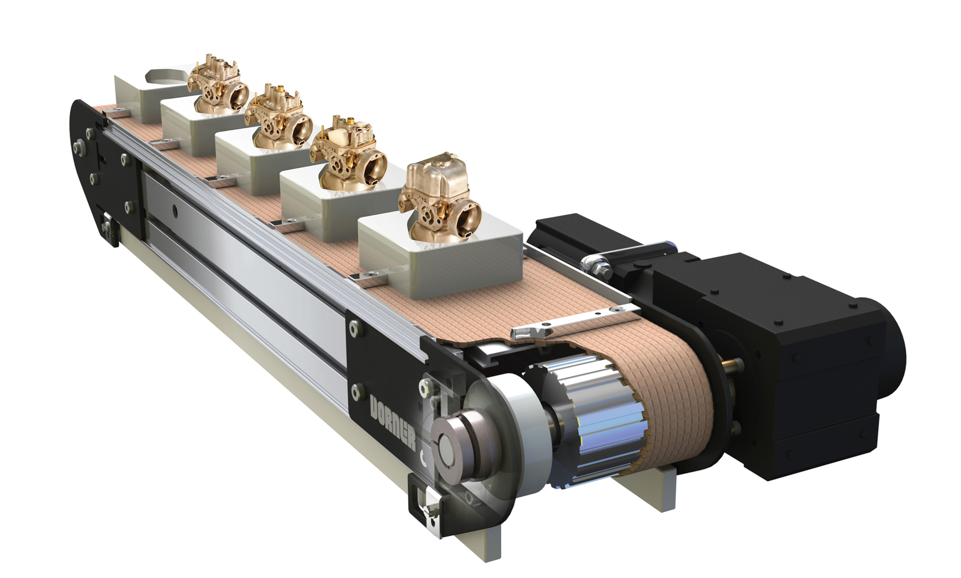

Precision Move 2200 and 3200 Series are suitable for applications requiring high repeatability. Belt widths range from 1.75 to 24 in., and lengths of 1.5 to 30 ft.

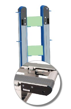

Another precision-conveyor application involves speed matching of tandem belts — using two parallel conveyors to move particularly wide pieces suchas long wooden boards or solar panels,for example. If the twin conveyors aren’t running at the same exact speed, or exerting the same amount of friction on the work piece, the part can begin to skew. Precision conveyors are useful in such applications, as they can be slaved together by one controller and maintain synchronicity. In fact, several conveyors can be run in parallel where required.

Shown here are two applications utilizing precision synchronization of twin conveyors — a vertical pocket lift and a horizonal tandem setup for moving wide plates and sheets.

• In contrast, some precision conveyors can integrate molded fixtures
called pucks. Here, lugs are bolted onto the conveyor belt, while the pucks — custom molded to cradle parts to be conveyed — are mounted onto the lugs. Attachment accuracy reaches ±0.005 in. Key to using pucks is a larger-diameter pulley drive, which allows the attached lugs to ride around the ends of the conveyor without issue.

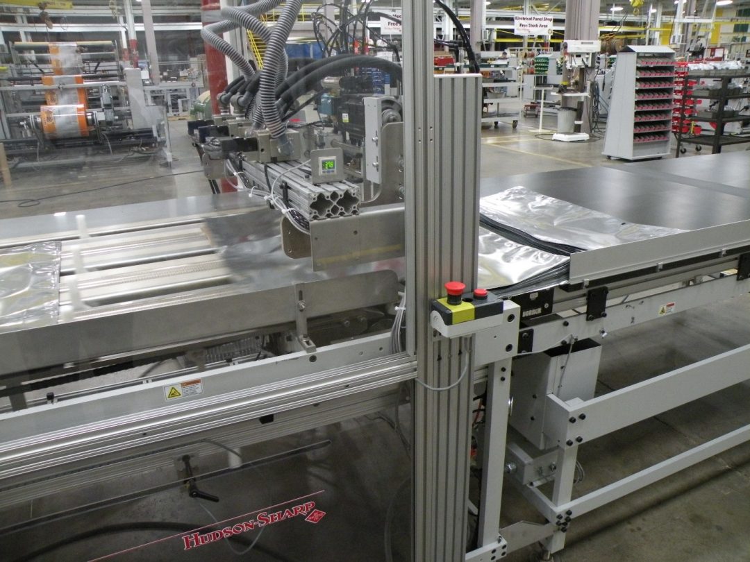

Cheers to better drinkware manufacture — at Tervis
Forget about it, beer cozies: Doubled-walled plastic drinkware is the reigning beverage accessory. Founded in 1946, Tervis, North Venice, Fla., manufactures the wildly popular insulated cups that keep drinks colder or hotter longer.
Tervis cup styles and sizes can be customized with virtually any design, so this automated line keeps track of special orders and the proper pieces to be assembled for each. The conveyors accurately synchronize lines to ensure that the robotic workstations assemble the cups properly.
To accommodate growth, Tervis recently expanded production floor space by 60%, increased workforce more than 40%, and further automated production. For design assistance, Tervis turned to RND Automation and Engineering of Sarasota, Fla., an integrator specializing in custom factory automation and robotic workcells for packaging and material handling. The direction from Tervis was to implement new automation for a steady, phased approach to assemble inner tumblers and outer tumblers — automation production steps requiring no human touch, and reducing repetitive-motion labor.
Today, multiple RND-designed lines run at Tervis.
A conveyor delivery system unites inner and outer tumblers at the robotic stations: Dorner’s 3200 Series Precision Move conveyor package (with new timing belt technology) provides repeatable movement accuracies of ±0.02-in. up to 100 indexes per min. — to accurately index the tumblers for smooth, uninterrupted production flow. The servo-driven conveyor has a flexible fixture attachment system, which accurately locates fixtures to within ±0.005 in. In addition, the precise conveyor has side guides that hold side-to-side tolerance ±0.01-in. for loading, unloading, or locating at assembly stations.
