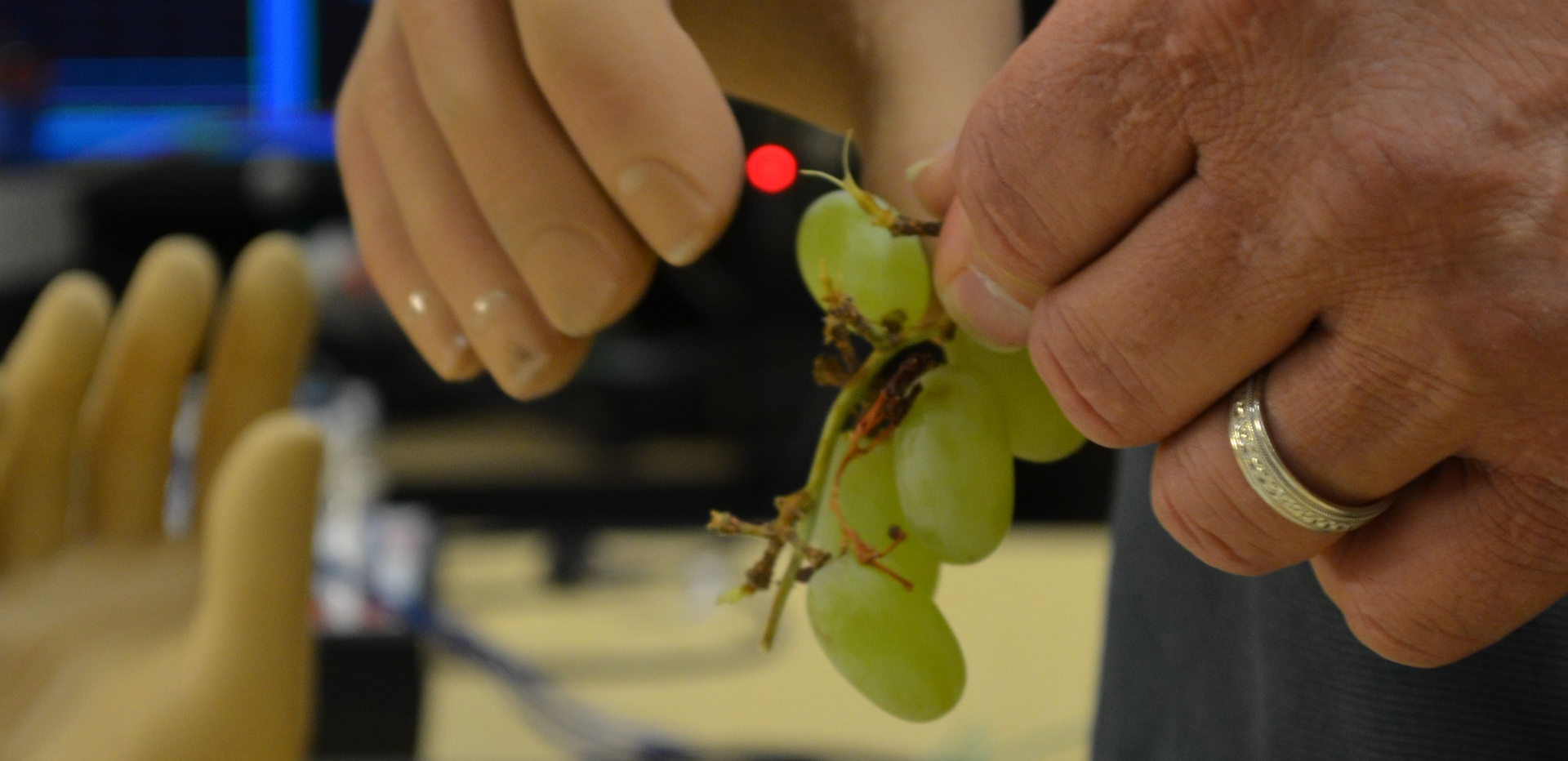

The sense of touch lets prosthetics users adjust their grips strength on the fly so they can pick up or manipulate delicate objects like these grapes.
